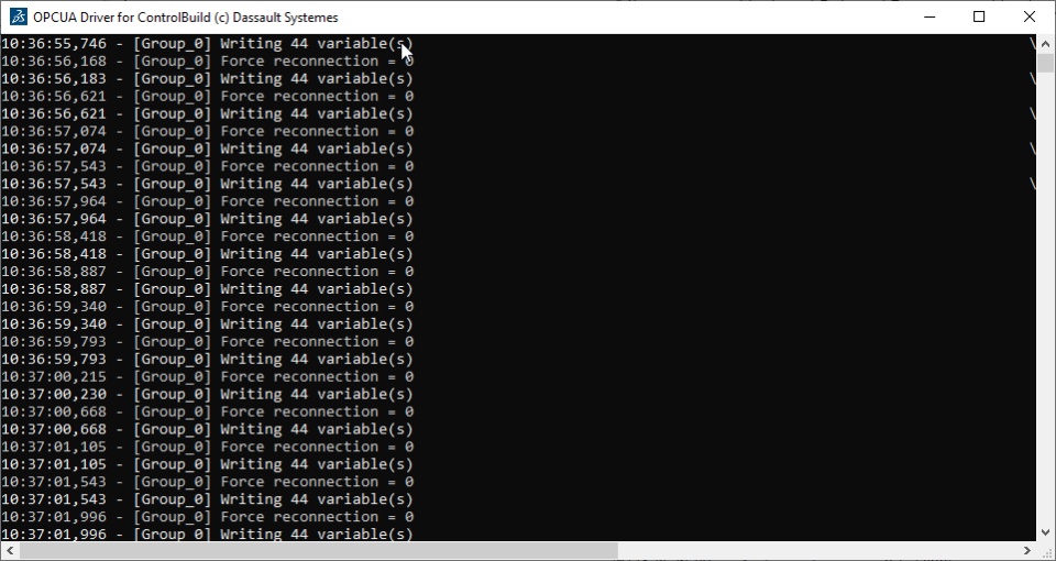

OPC-UA Communication with ControlBuild 21x driver
I am trying to establish communication with OPC UA server through the OPC-UA driver from ControlBuild 21x. I was able to create outputs & connect them to the OPC Server nodes through the OPC-UA Connector utility. Furthermore, my project gets compiled & executed in functional view. However I don't see any updates on my variables. The values remain default although the OPC UA server is changing values. Please find screenshot of the driver output. I am not sure why force reconnect is called. Is this normal output? @DM ​​​​​​​It would be great help if you could give some guidance.
