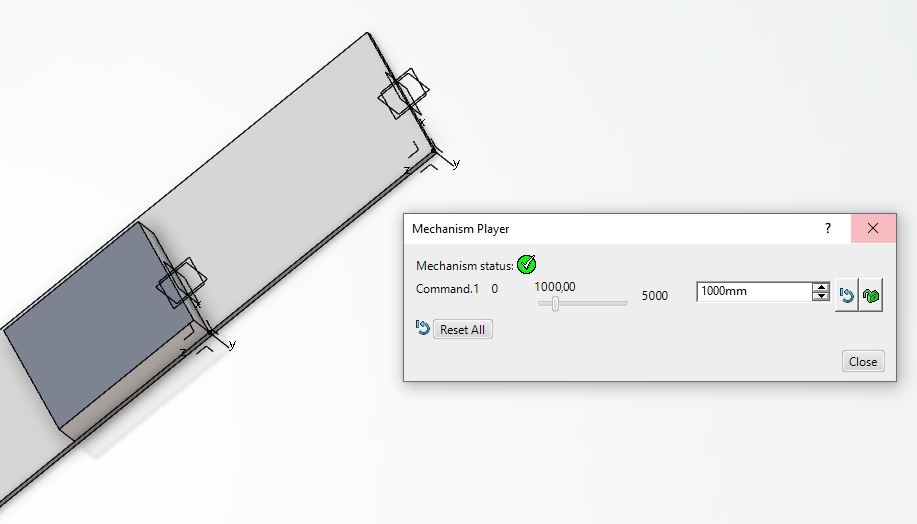

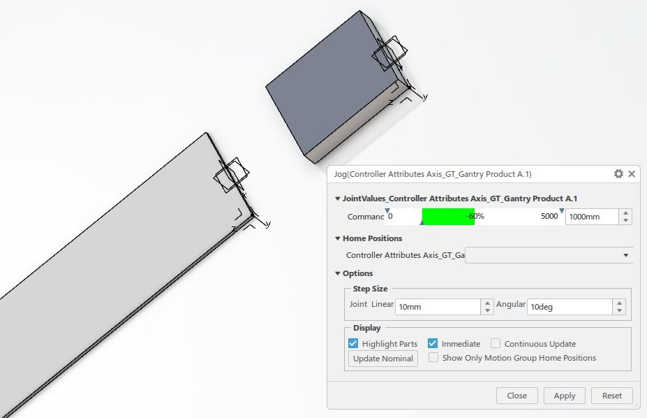

I have a question about building a simple mechanism in Equipment Design application. The mechanism consists of prismatic joint based on axis systems. To move the mechanism I get two different behaviour:
- double clicking the joint command in the tree and setting positive value of the command the slider moves left as Z axis for prismatic joint is defined, what seems to be correct
- using Jog mechanism and setting the same positive value for the command the slider moves in the opposite direction
Does anyone know how to fix this problem
