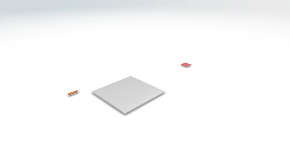

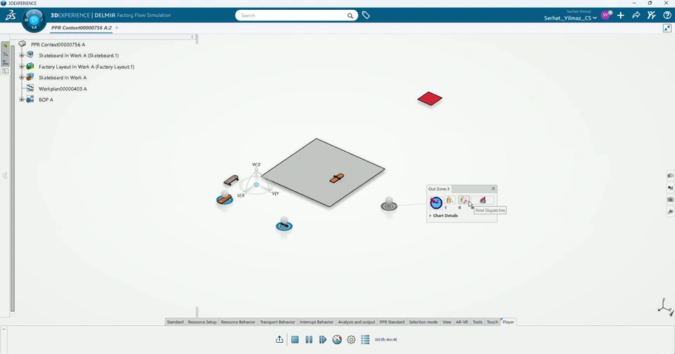

In the example scenario below, I am experiencing an issue where the part is not dispatched to the OutZone as expected.
The scenario consists of two stations: Station 1 and a Rework Station. Both Operation 1 and the Test Operation are performed at Station 1.
  • If no rework is required after Operation 1, the part proceeds directly to the Test Operation at the same station. After the Test Operation is completed, the part should be dispatched to the OutZone.
    Operation 1 --> Test Operation --> OutZone
  • If rework is required after Operation 1, the part is routed to the Rework Station, where the Rework Operation is performed. After the rework is completed, the part returns to the Test Operation. Once the Test Operation is completed, the part should again be dispatched to the OutZone.
    Operation 1 --> Rework Operation --> OutZone
However, in both cases, the part is not dispatched to the OutZone as expected.
Which settings should I check in the flow, operation, or station definitions to ensure that the part is correctly dispatched to the OutZone ?
