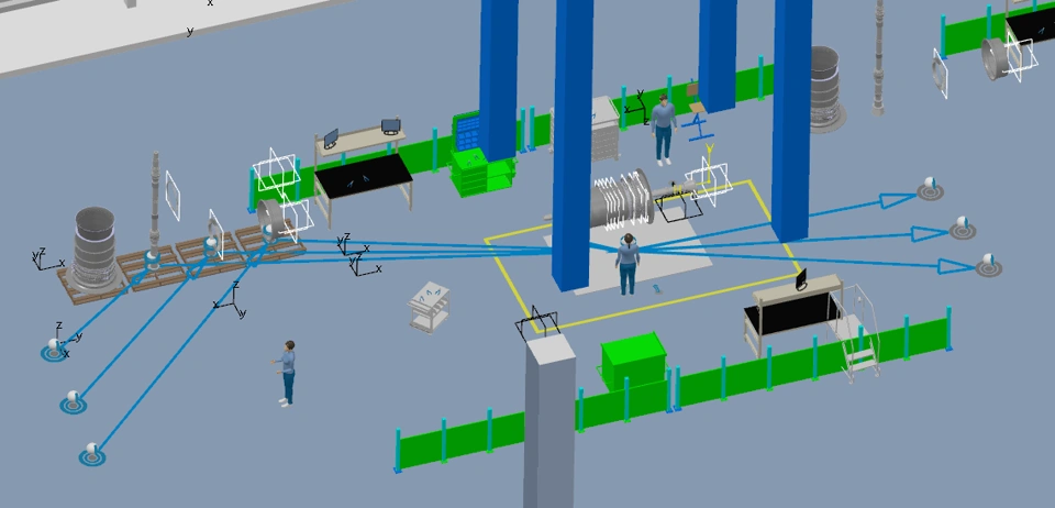

I am testing a scenario in Factory Flow Simulation where multiple different products are manufactured on the same NC machine resource. The manufacturing process requires these different products to stay at the workstation while one of them is being worked on, so they are processed in a specific order, sometimes even simultaneously by multiple workers.
My question is, is it possible to assign logical connection between these activities, e.g. transform activity of another product can only begin after a specific activity of first product is completed?
I know I can set an order with the Gantt-diagram, but I'm thinking of a more detailed connection, maybe even including worker resources or other requirements for one activity to start.
Would this be possible with the use of Manage Logics function on the Resource Behavior panel? I don't know this function, but maybe this is what I'm looking for.
