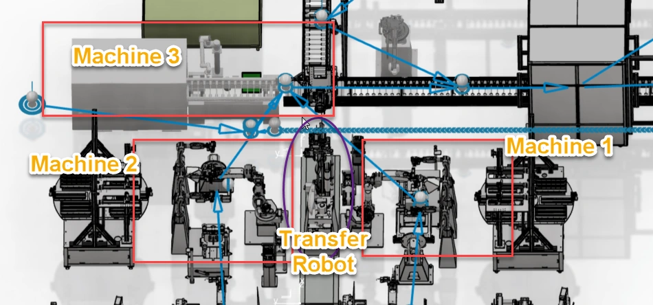

I have two NC Machines that feed product to another NC Machine via a Transfer Robot to 'Machine 3'
- The part that has been waiting the longest to leave the either Machine 1 or Machine 2 should be selected by the transfer robot and move to 'Machine 3'

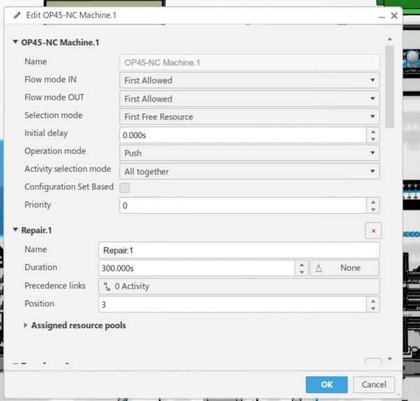

- I have tried every Selection Criteria in Flow Mode In and Flow Mode Out but I still cannot get the model to perform as expected
Any guidance that anyone could provide? does this need logic written for it?
