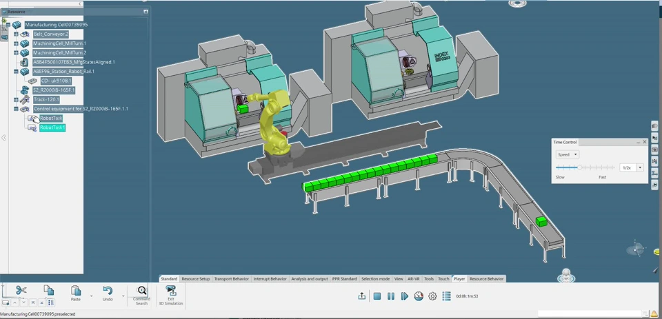

I'm facing a problem while assigning a robot service task to the product flow for loading or unloading a product onto an NC machine in Factory Flow Simulation
I have created the product flow between the conveyor and the NC machine. In that flow, I assigned the robot to load the product and also created a robot program for the loading activity. I assigned that program to the product transfer activity, but the robot movement is still not occurring.
