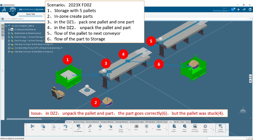

Hello,I tried to Create an unpack activity at a Conveyor Decision Zone, but it didn't work. Could you pls find the issue and give me some suggestion? Thanks.
