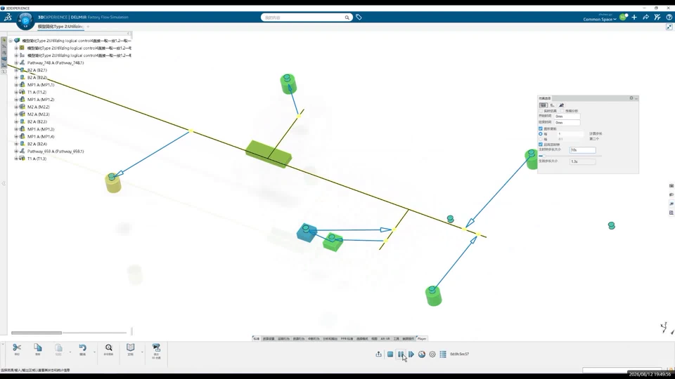

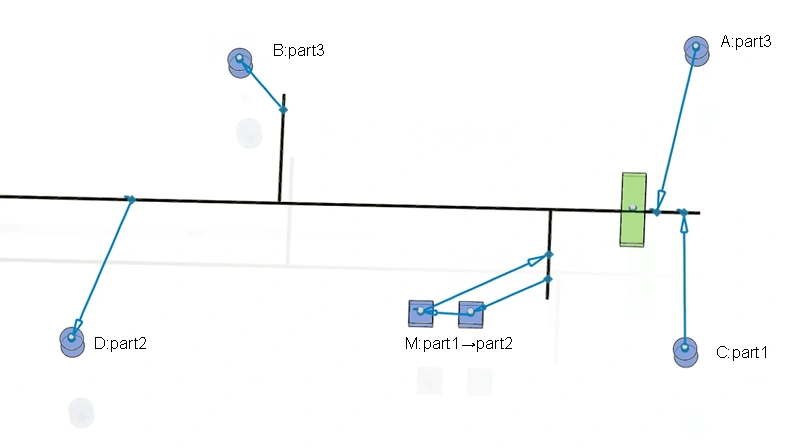

Hello everyone! I'd like to ask my colleagues how to use the AGV's "highest priority pending task" task selection mode. Could you please advise on how to change the AGV's task assignment logic from "first-in, first-out" to "highest priority task first"?The capacity of AGV is 2.
Currently, the following settings are not functioning as intended: the AGV task selection mode is set to "highest priority pending task," with AGV DZ3 and AGV DZ9 assigned a priority of 0, while all other decision points are set to 1.
It was expected that when AGV DZ3 had a workpiece, the AGV would first head to AGV DZ3.
However, in practice, the AGV went to other AGV DZs instead—specifically around simulation time 7 : 52 , the AGV failed to go to the higher-priority AGV DZ3, choosing instead to proceed to AGV DZ4 and AGV DZ6, and did not pick up the workpiece from AGV DZ3 even after passing by AGV DZ2.
