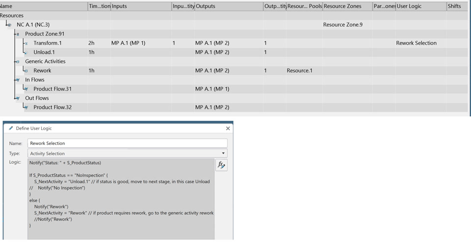

I would like to have a rework occuring on the same work center.
I just have a single flow line, an NC machine and then a buffer and an outflow.
If the part is "rejected". My General Activity Rework will occur, but after that the fixed part will sit in the work center and my work center will be idle. I think the issue is that my work center is now expected to do "Unload", but it can't since it doesn't have an output product to reject.
If the part is "good", the unload activity will occur and the part will go to the buffer. But after that my work center will be idle and new inputs won't go to it. I think the issue is that my work center is now expected to do "Rework", but it can't since it doesn't have a rejected product.

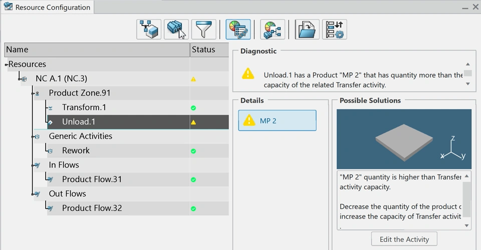

Attached is a screenshot of my work center and logic. I realised in troubleshooting that a part is "good" has a S_ProductStatus of "Noinspection"
In the continuity i have the following warning, but I've never encountered this issue before and don't know how to resolve it. Since I don't have a transfer activity defined
