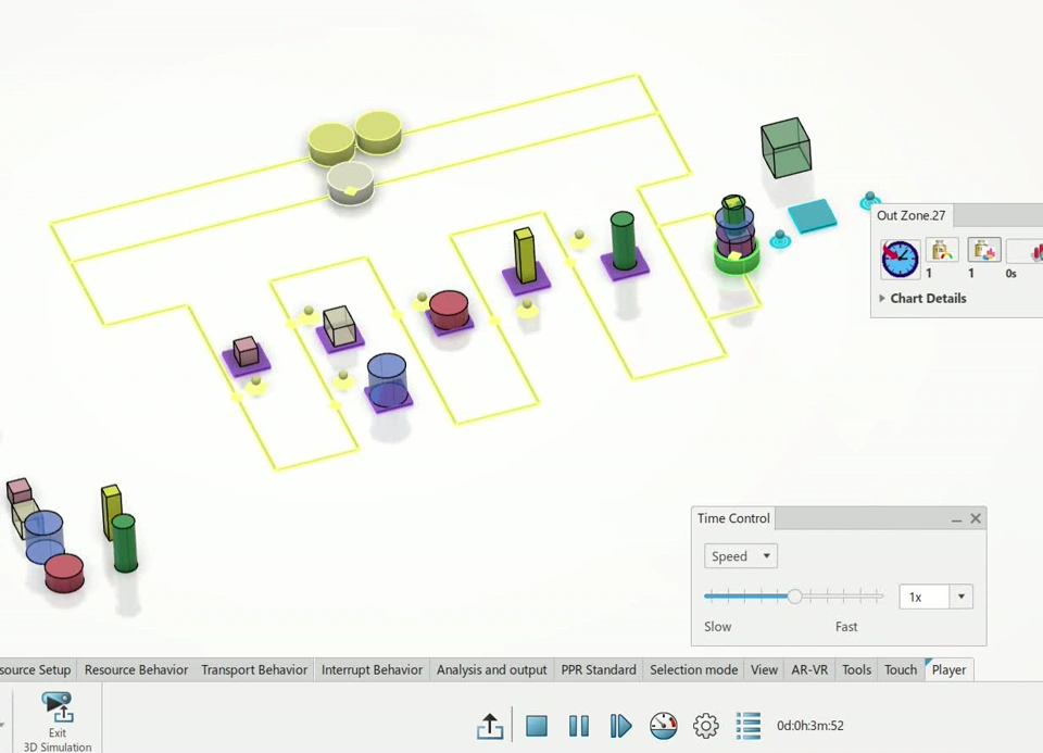

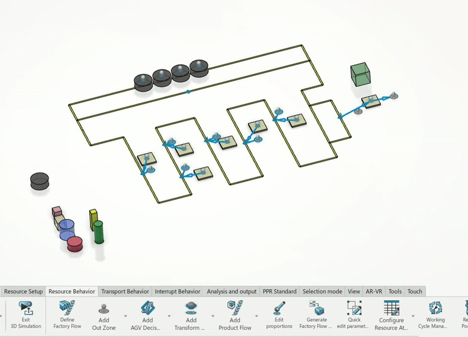

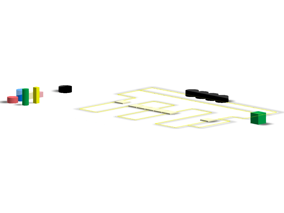

I am developing a warehouse material flow simulation where four AGVs (trolleys) pick parts from multiple storage locations/aisles and deliver them to a common drop-off location.
The scenario may involve a large number of pickups (e.g., 150+ parts distributed across various pickup points), so I want to ensure that the model architecture is scalable and follows best practices.
Current Modeling Approach
I have attached the 3DXML model for reference.
The current model contains:
  • 4 AGVs assigned to pick parts from different pickup locations.
  • Multiple pickup zones connected through product flows.
  • A common drop-off location.
  • NC machines placed near pickup locations to enable Pull operation mode in zones.
I am encountering several issues and would appreciate feedback on whether my modeling approach is correct.

1. AGVs Not Starting Simultaneously
At times, only one AGV is triggered. The remaining AGVs remain idle until the first AGV completes all of its pickup and delivery tasks.
Expected Behavior: All four AGVs should be able to operate concurrently when parts are available.
2. Pickup Sequence Not Followed
Some AGVs do not collect all required parts in the expected sequence. They occasionally skip pickup points and appear to select parts randomly.
Expected Behavior: AGVs should follow the defined product flow and complete all scheduled pickups.

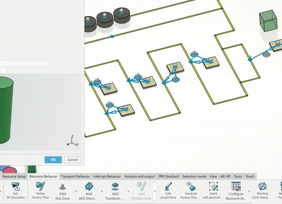

3. Pull vs Push Mode Challenges
To use Pull mode, I added NC machines near each pickup location because without a resource, products are not generated in the zones and AGVs do not receive pickup requests.
When I switch all zones to Push mode, the model functions but simulation performance becomes significantly slower.
Questions:
  • Is adding NC machines near pickup locations the correct approach?
  • Is there a better method to generate pickup demand in Pull mode without creating dummy resources?
  • Are there recommended practices for large-scale warehouse pickup scenarios?

    • Only 1 AGV is working at a time.
    • Direct flow from In zone and keeping mode Pull is not triggering AGV pull.
    • Changing in zone to pull then adding a NC machine before load is triggering simulation well.
