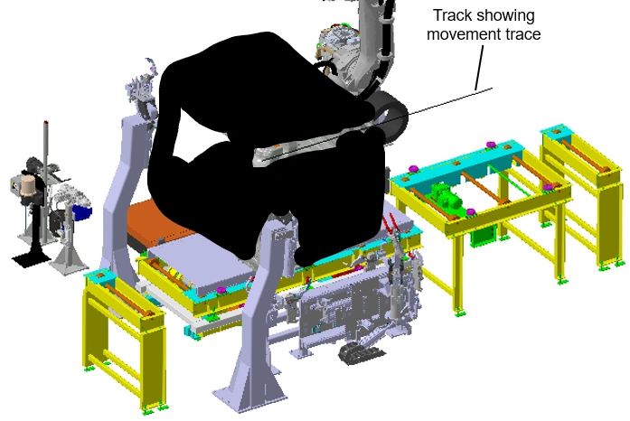

In Delmia V5, there was a Simulation Activity Creation toolbar within which was a Create Move Activity function that allowed users to move a product or a resource between two or more points during a simulation playback.

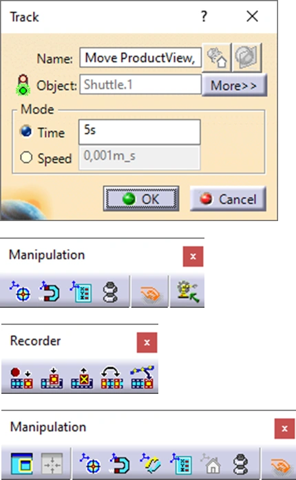

When this function was selected, the user was asked to select Products and/or Resources and with the Recorder toolbar, the user recorded positions of the selected objects with the compass (which is attached to the selected objects)
A trace will be created corresponding to the paths recorded and the selected objects will move along this track during the simulation.
