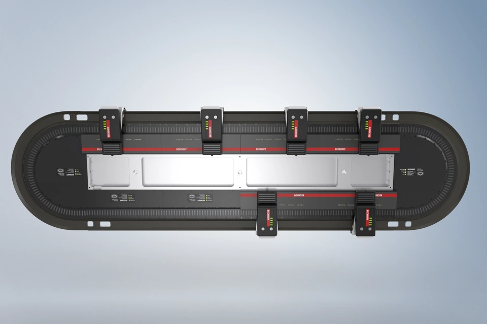

I can have up to 150 grapping commands in one simulation, due to the production line using an Beckhoff XTS to move parts, which can have 150 movers:
