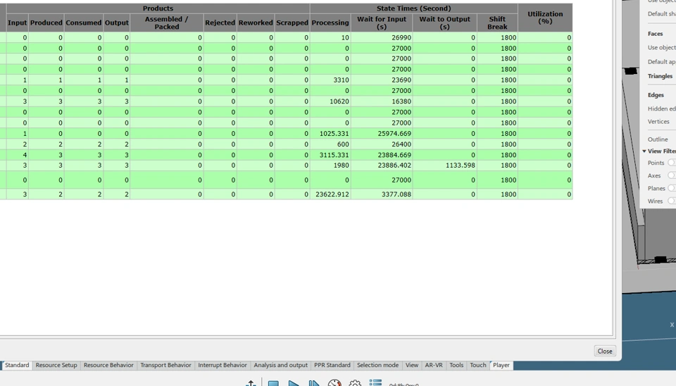

- When I run the simulation only for Shift 1 (0 sec to 8 hr) and open the Shift Report under System Performance Indicators, the Throughput and Utilization values are showing 0 for the entire report.
If I continue the simulation beyond 8 hours (partially), then Shift 1 report shows no utilization data, and other shift reports show partial values.
the above image is 0 sec to 8 hrs. first shift report
- Even after changing Shift End Behavior, the issue remains the same.
