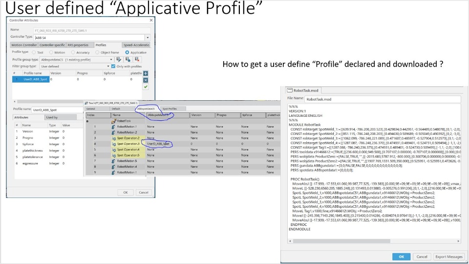

1. How to get a user define “Profile” declared and downloaded ?
See picture 1.

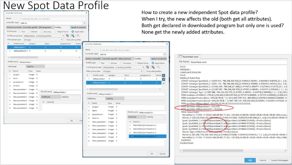

2. How to create a new independent Spot data profile?
When I try, the new affects the old (both get all attributes).
Both get declared in downloaded program but only one is used?
None get the newly added attributes.
See picture 2.
