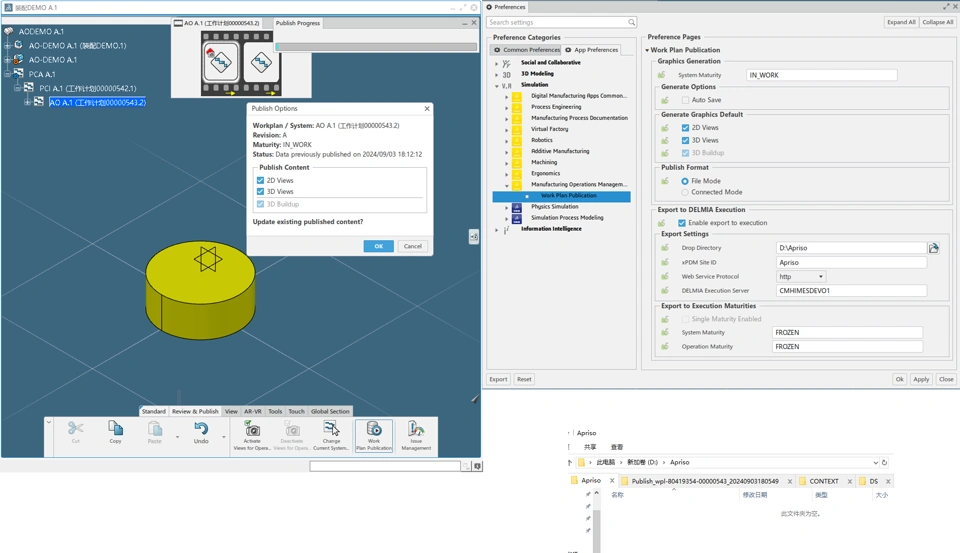

Work Plan Publication

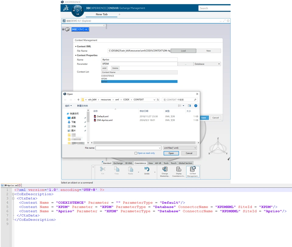

The Work plan publication function is used to publish the work plan, but the file is not exported in the specified directory.  May I ask how to set it to Export the file in the specified directory
Client version R2021X HotFix08
