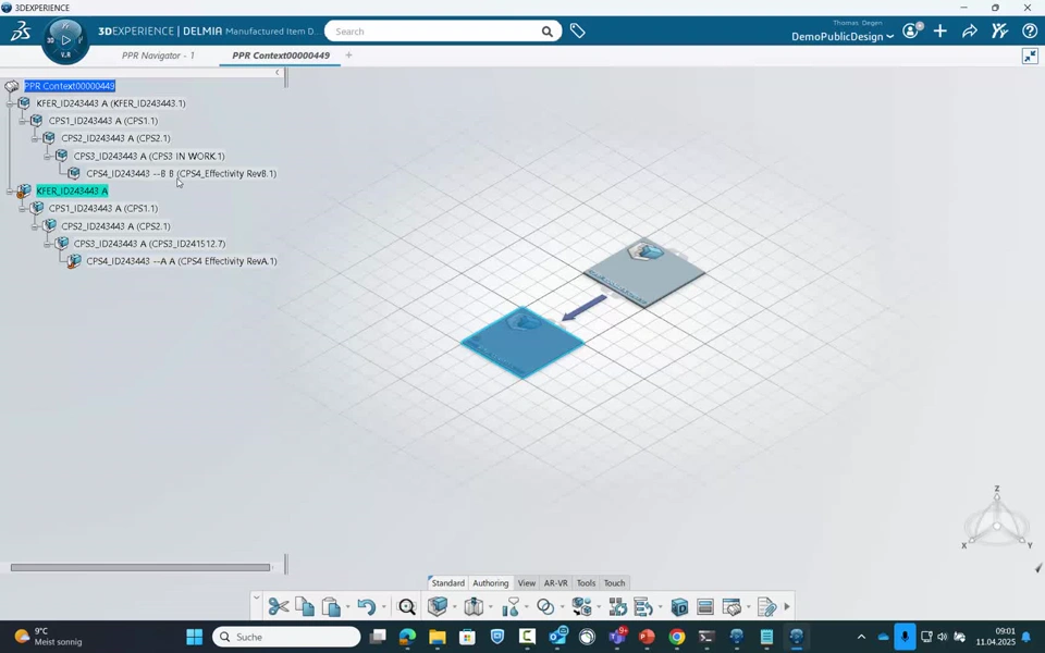

Our customer works with configured E-BOM and M-BOM.
In the example there is a variant of EBOM which shall be transfered to M-BOM. A simple reroute is an incorrect solution because M-Item A is scoped with E-Item A and still in use as variant.
If user want to revise the M-Item to B he get allway the error "Configured Revison creation is not yet available on M-Item - (NonLinearVersioning.Error.ConfiguredRevisionNotAuthorized). Please contact your administrator".
A video of the scenario is attached.
How could the the challange be fixed? Customer is using R2024FD06 oP, scenario is recored on R2025FD01 oC.
