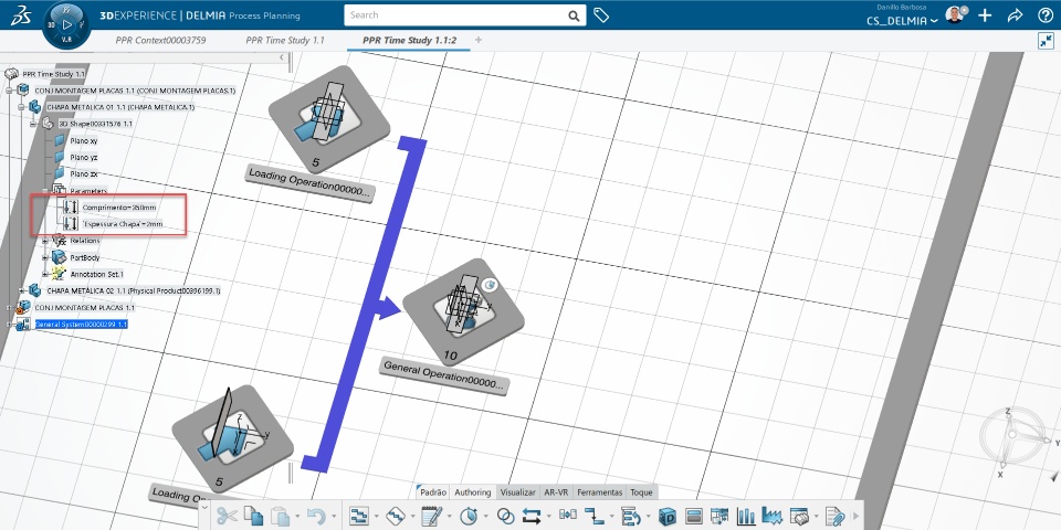

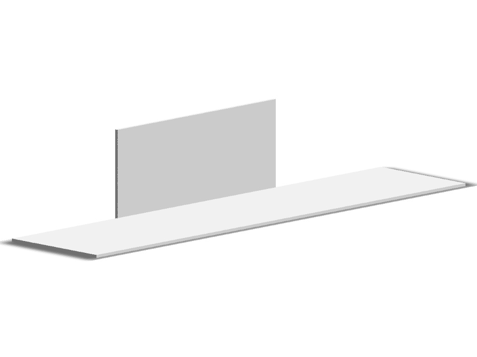

Hello everyone, is it possible to vary the operation time based on CAD model variables? For example: If the length is 200mm the operation time will be 20s, if it is 3000mm the time will be 45s.

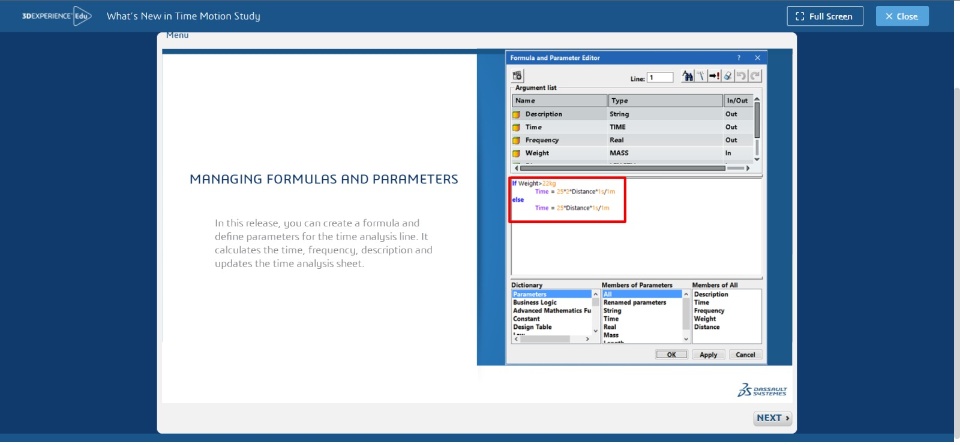

I found a solution considering the TMA Time Analysis trigram
But it is necessary to create the variables and set the manual values, I would like consider these parameters already created from CAD or get these automatically
