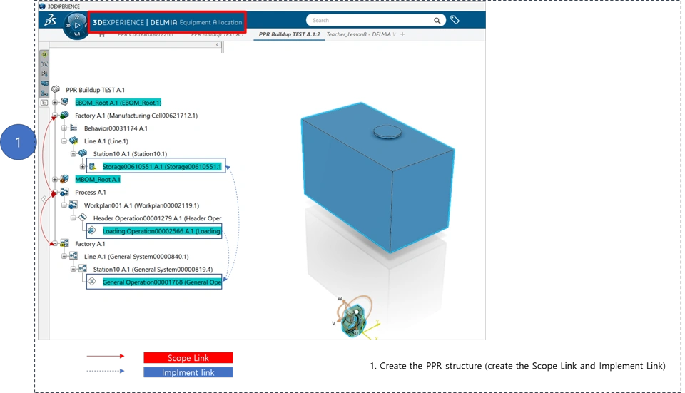

Operation Position Function Not Applied in the Workplan/System-Based PPR Structure
The Operation Position function is not functioning properly in the Workplan/System-based PPR structure.

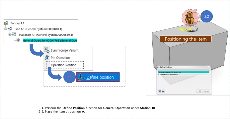

The execution steps are as follows.
  1.  Create the PPR structure (create the Scope Link and Implement Link)
  2. 2-1. Perform the Define Position function for General Operation under Station 10.
    2-2. Place the item at position A.

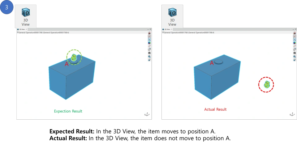

  3. Check the result in the 3D View environment.
    Expected Result: In the 3D View, the item moves to position A.
    Actual Result: In the 3D View, the item does not move to position A.
