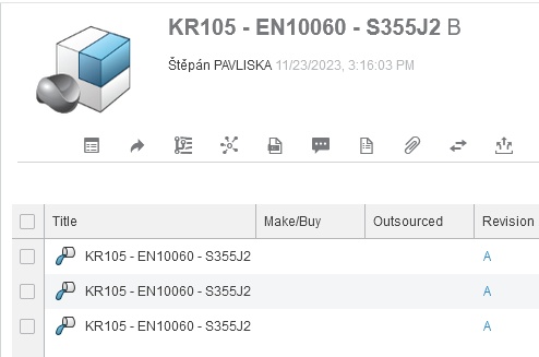

When Mfg Responsibility is defined for Raw Material beforehand, it doesn’t seem to be considered afterwards in MFN. The app still creates new Continuos Provided Material, when the parent Product is dragged and dropped into Mfg Assembly.
Which means, that there is going to be new Continuos Provided Material in the database for every single Make From relation on scoped Raw Material.
Why is that the case and is there a way around this?
I think it makes sense to only have one Mfg Responsibility and reuse it with a different quantity.
