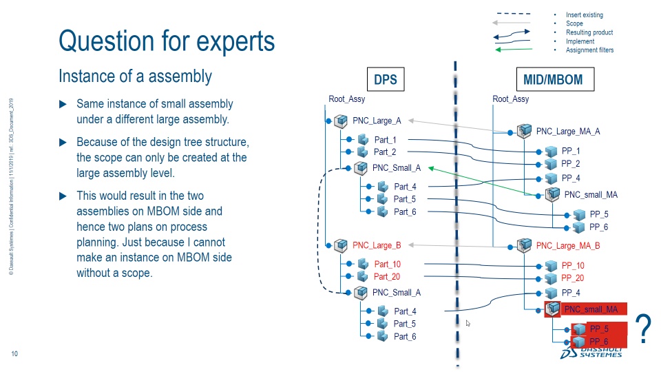

Mfg Item Structure: How to manage Manufacturing Assemblies that cannot have a scope (no corresponding Eng Item)
*** Subject text modified by admin ***
I have come across a problem in the MID app. The structure of the design tree does not allow me to make a scope on MBOM.  If I, as a manufacturing engineer, cannot scope an Mfg Assembly to an equivalent engineering item, I will end up having multiple MBOM and Process Plan for the same design. This scenario is shown in the attached media.
Please help me out with this critical situation.
