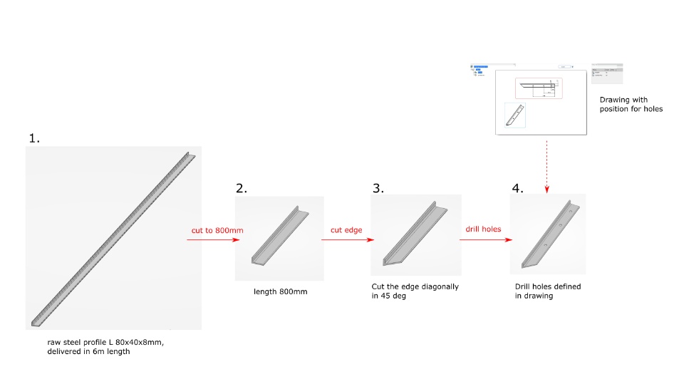

Hi all,
I am thinking about case attached in picture. How would you create MBOM structure? Which type of nodes would you use (manufactured part, remove material,, continuous material)? And speciall, how can be drawing for holes be attached to MBOM node (or to operation in process plan?)
I would like to use Manufactured Part but there is restriction that Mnf. Part can not contain another Mnf. Part and there I am lost :/
