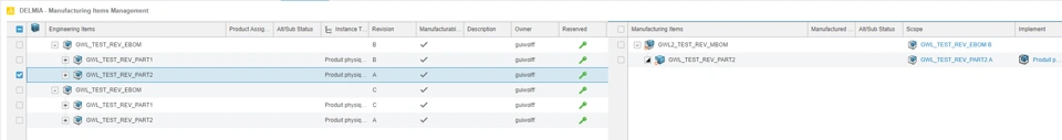

I have an EBOM rev B and a MBOM rev A.

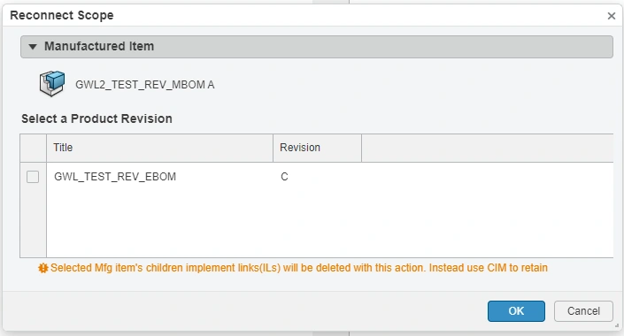

If my EBOM get a new revision to rev C how do I update the links of my MBOM rev A?
I tried to use the Reconnect Scope Link
I can then reconnect the MBOM rev A to the EBOM rev C but there is a warning at the bottom which explains that the Implement Links from the children will be deleted.
So if I continue I will delete the Implement Link of my provided Part.

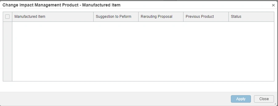

It says "Instead use CIM to retain" (Change Impact Management).
If I try the CIM it does not propose anything :
Did I miss a step?
