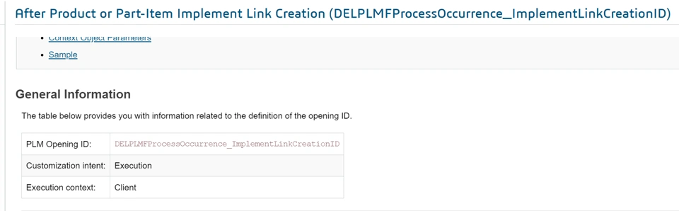

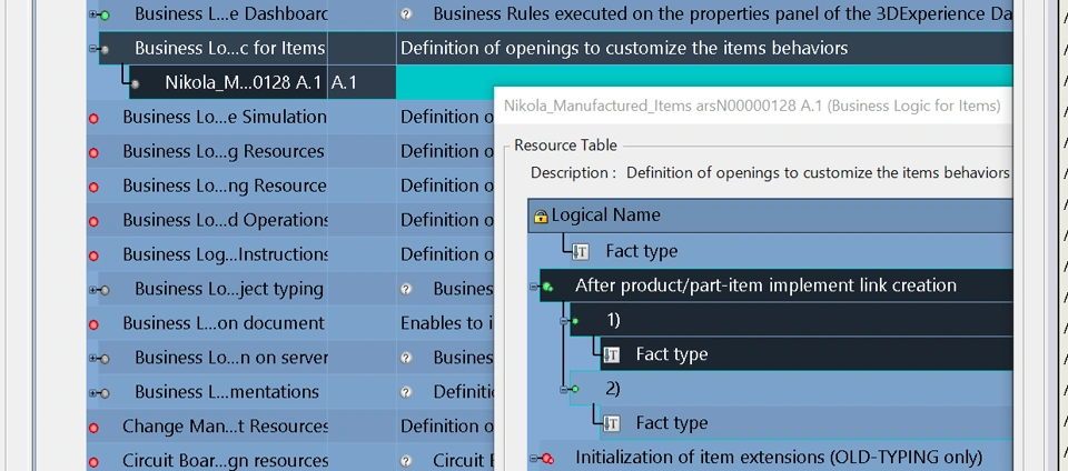

Update 06/20/2024
I was able to find the Entry Point in Dataset Up, but this seems to be Only After the Creation of the Implementation Link, how do i maintain value changes between the EBOM and MBOM?
