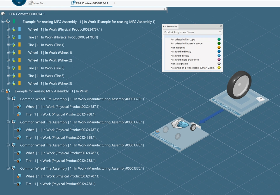

My actual structure is a little more layered than this screenshot example, but this is essentially the same thing.
I have four instances of a wheel, and four instances of a tire. I install a wheel and tire together and inventory that assembly.
I want to use that manufacturing assembly to implement all four wheel instances and four tire instances.
I'm open to using "phantoms", installations, resulting products, or whatever other option is recommended for this, as long as I can, in the end, show four manufacturing assemblies in the MBOM, and have all four show the same EIN, and show all wheel/tire EBOM instances as implemented.
What're your thoughts?
