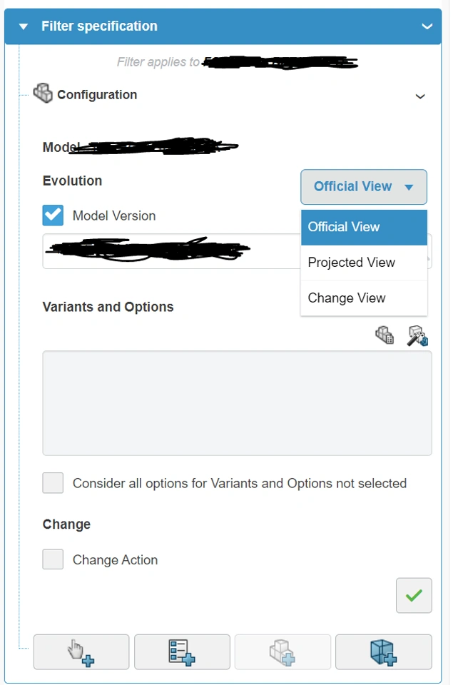

Hi everyone! This was posted in the ENOVIA User Community, but considering this includes Manufacturing Plans, I figured I'd post here too:
I am utilizing Configuration Management and Change Management to leverage the Projected View and Official View, helping to filter In Work content out of the EBOM/MBOM prior to Change Action Release.
When using a Change Order to orchestrate changes, there is a lifecycle called "Implemented". I am trying to use this lifecycle to create an additional Model Version and Manufacturing Plan Filter - as shown below.
End Goal: Filter to an EBOM/MBOM that is representative of what is truly Implemented in ERP/MES, not only what is Completed with respect to completion of approvals and release of parts into the EBOM/MBOM.
Has anyone found a way to create a filter view that equates to Implemented COs?
Change Order StateModel Version/Manufacturing Plan Filter View
Draft/In Work/In Approval/ApprovedProjected View
CompleteOfficial View
Implemented?????
