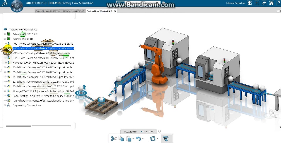

Hello,
I am working on Factory Flow Simulation in 3DEXPERIENCE 2015x and have a question on how to integrate Kinematics with FFS. I have given the material flow to the product in the workcell and defined the kinematics of the machine. Now I need to create a task for the machine, invoke the task in the FFS app and run the simulation using the Dynamic Level 2 button. However, I am unable to create a task for the machine and cannot invoke it. I have attached a video to explain the scenario.
Would appreciate any suggestions.
