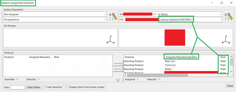

I have a question regarding “manipulation data” between Mfg Item Occurrences and Operation Occurrences. I am talking about the data in the “Role” column in Systems Assignment Assistant in DELMIA (see the following image with several rows with the “*Add” Role).

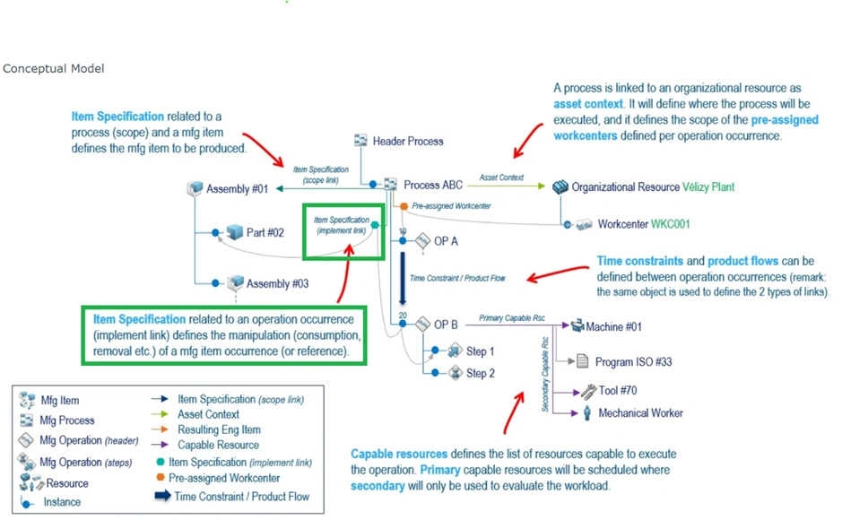

According to the following Conceptual Model this data resides on the “Item Specification (implement link)”
Please see next attached image.
