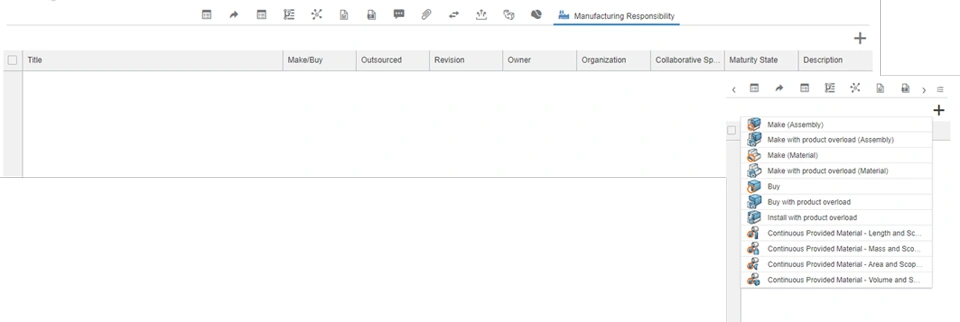

Figure 1: Manufacturing Responsibility in Engineering Release

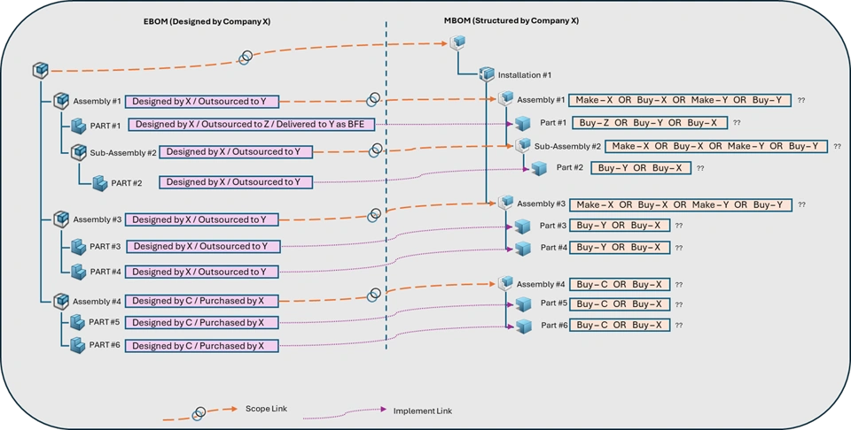

Figure 2 below shows the classifiable EBOM Parts and Products to MBOM, as well as their industrialization strategies.
Figure 2: classifiable EBOM Parts and Products to MBOM, as well as their industrialization strategies.
Questions:
According to the best practices and recommendations:
  1. What is the correct classification of Manufacturing Responsibility to all the orange boxes in Figure 2? and Why?
  2. Would it make sense to model Assembly #1, Sub-Assembly #2, or Assembly #3 as Provided Parts? Company X do not assemble these parts and are not responsible for Routings or Work Instructions .
  3. Since Assembly #4 Design is not owned by X, then modeling it in MBOM as Provided Part seems to me the best course of action, however, do I need to classify the parts below it as Provided Parts as well? What are the business case scenarios that I need to consider?
