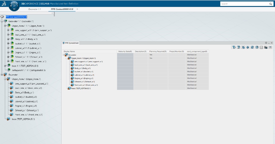

has anyone already find a solution how we can automatically map attributes from EBOM to MBOM?
For example I have ProjectNumber defined at the EBOM in all physical products -> I have also ProjectNumber attribute on my objects Manufacturing Assembly and Provided Parts -> How I "copy" this attribute? Copy+paste is not a solution.
I didn't find any OOTB solution for that? Maybe someone has done a EKL script for that? We are using CLOUD environment so there is also restrictions what we can do at the server side.
