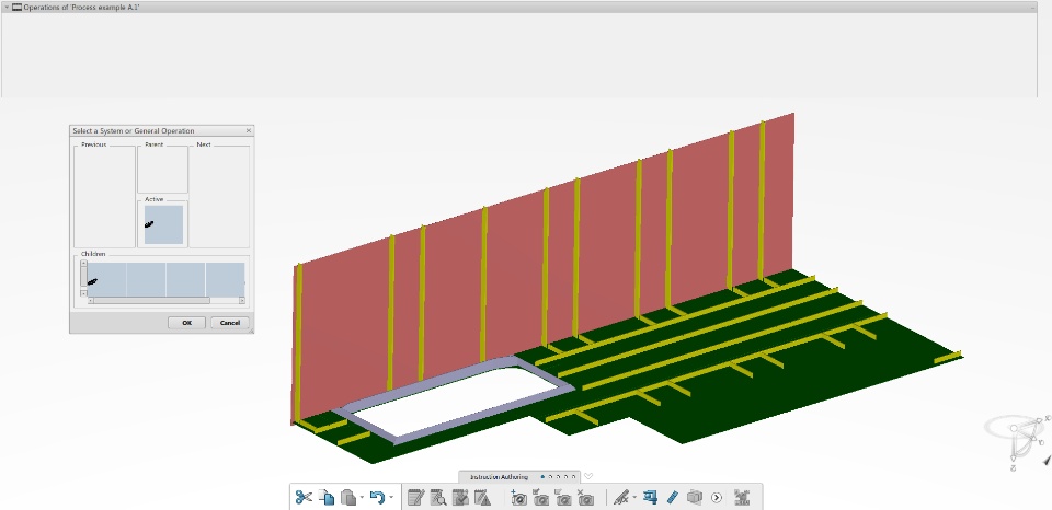

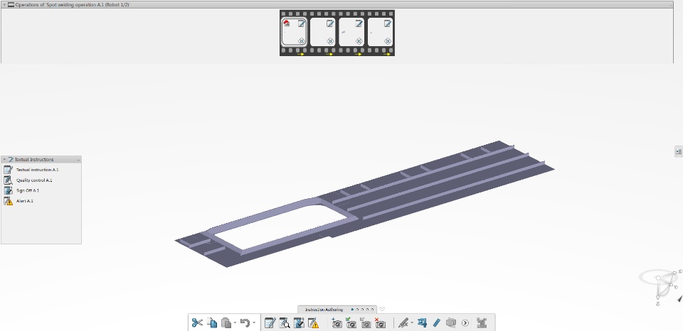

I want to keep the 3D-data coloring shown i figure 1 in every operation, which means that I turn off the B.I. essentials function. But this only leads to the grey color shown in figure 2. Is there any possibilities to prevent this from happening?

The issue is related to a special handling of colors (and other properties) on product structure occurrences via the command "Product Graphical Properties", that cannot be taken into account in all cases in Manufacturing Planning applications, depending on how the implementation is modeled.
