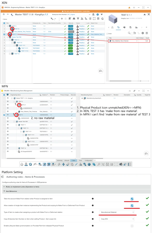

I am facing the following problem and need help.
1. Physical Product Icon unmatched(XEN<->MFN)
2. In XEN, TEST 3 has ‘make from raw material’.
   In MFN I can’t find ‘make from raw material’ of TEST 3
I have tried consulting Appendix 1, 2, 3, but it has not been resolved. I am using a Public Cloud environment, and I am currently using 3DEXPERIENCE Solidworks.

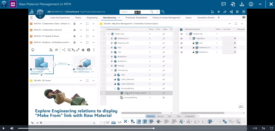

Appendix 1:
original link
Appendix 2:
Scenario 4
https://youtu.be/-uvhAZeeneE?si=8ERdrsLP3VgugAGx&t=2657
