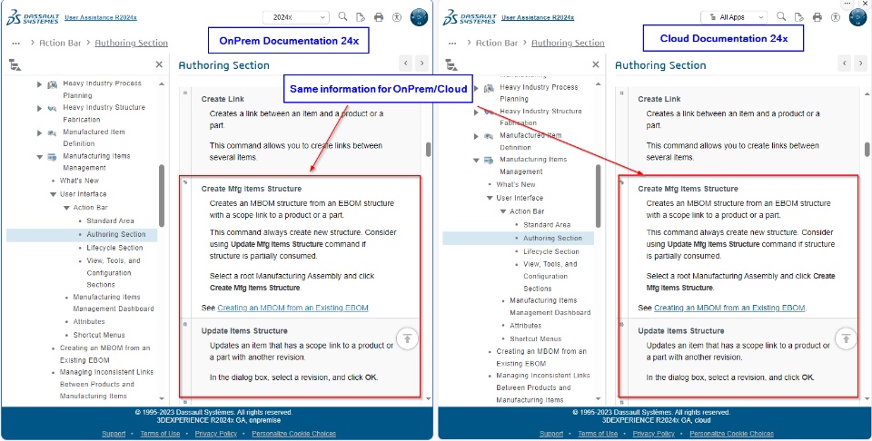

Just a quick update, under current 24x documentation both commands, Create Mfg Structure and Update Mfg Structure appears listed for OnPrem and Cloud versions. ​​​​​​​

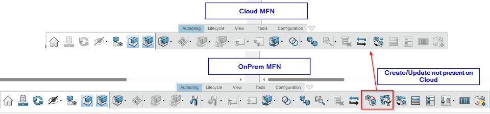

Also, I tested MFN with all the major browsers and the above information is not true. (Which I guess is a error on the docs.​​​​​​)​​​​​​​
