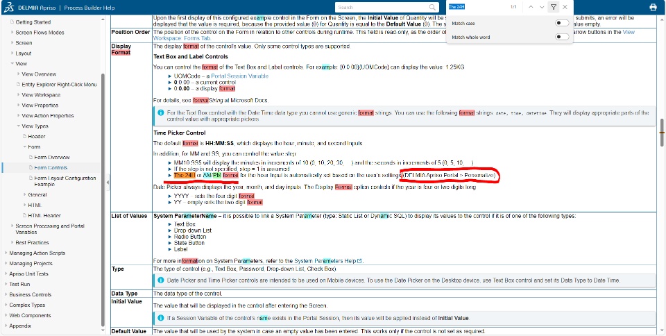

In the documentation for Process Builder 2023, there is a section in "Display Format", "Time Picker Control" that states the following:
> Time Picker Control
> The default format is HH:MM:SS, which displays the hour, minute, and second Inputs
> In addition, for MM and SS, you can control the value step:
- MM10:SS5 will display the minutes in increments of 10 (0, 10, 20, 30, …) and the seconds in increments of 5 (0, 5, 10, …)
- If the step is not specified, step = 1 is assumed
- The 24H or AM/PM format for the hour Input is automatically set based on the user's settings (DELMIA Apriso Portal > Personalize)

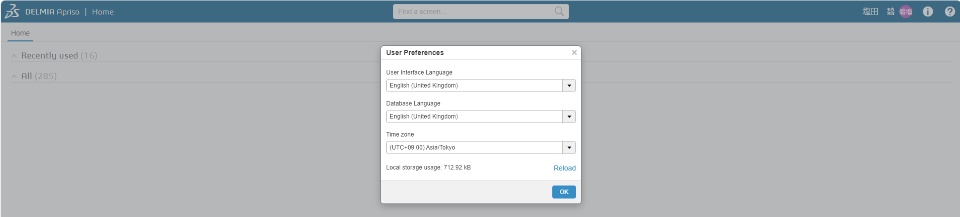

In this section, it states that setting which decides what the "time-picker" displays is located in the user's personalization settings. However, we cannot seem to find these settings in the user's personalization section in the Apriso portal.
Are we looking at the wrong portal? Where should we be looking and/or what should settings should we modify?

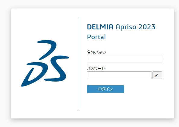

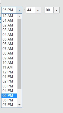

I have linked 5 images below. The first image is the section of documentation I am looking at. The following 3 images is the route I am taking to get to the "personalization" menu. The last image is the current way the "Time-Picker" dropdown is being displayed. We want to modify this so it displays 24hour time, instead of AM/PM
