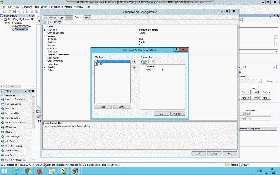

I’m getting very strange results with the colour change for the gauge.
For the operation I created in the lab,

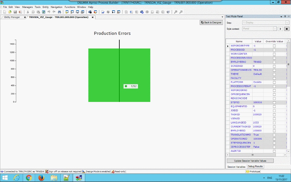

  • The query returns 1292.
  • I’ve set the gauge maximum to 1500.

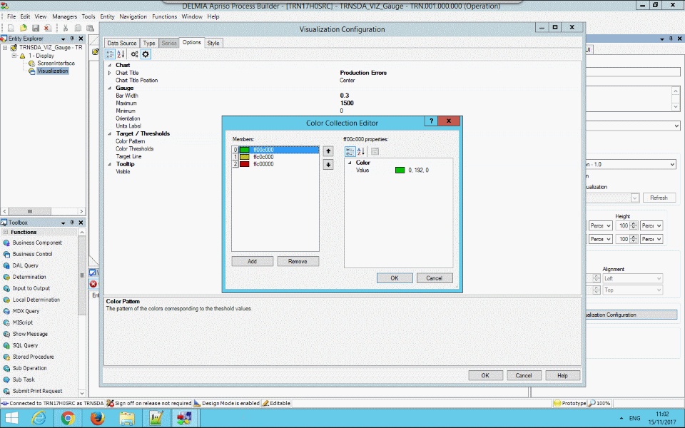

  • Three colours – green, yellow and red.
  • Two thresholds 1290 and 1300.
So the gauge should be yellow right? But it isn’t, it’s green.
In order to make the gauge show yellow, I have to set the first threshold to 86. If I set the threshold to 87 or above, the gauge still shows green. Now that’s curious, because 1292 * 100 / 1500 = 86.1, so it looks like the thresholds need to be configured as a percentage of the gauge range, and not an absolute value.
Except…
If I look at the TRN_VIZ_Gauge operation that was already present on the VM (so not the one I created), it behaves as expected. The thresholds are 1290 and 1300, and it is correctly displayed in yellow when the query returns 1292.
I cannot see any difference in the configuration between the original operation and the one I created, so what could explain the different behaviour? Or what configuration option have I missed?
I hope this makes sense, see the screenshots if that helps.
