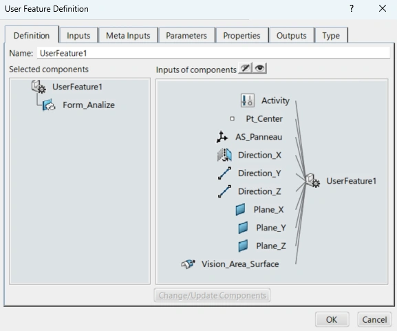

We can't create a UDF with a Visual script result because the result is isolated, and UDF does not allow it.

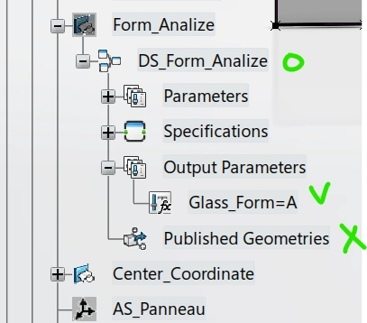

So, I used it only to create a parameter output("Glass_Form" in the image), and it worked.
I am not sure since when. Today, when I create a new UDF in the same way, the results are empty under Published Geometries. But I can't create a UDF anymore. With the message below. Since published geometries are always there, even if empty, we can't add a visual script into UDF anymore.
Any reason not to use Visual Script in UDF?
