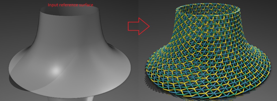

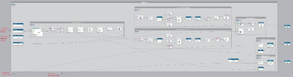

I can't currently find a solution to finalize my little pattern :

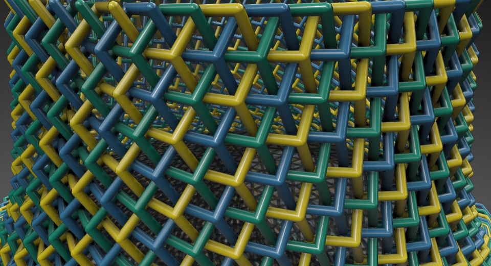

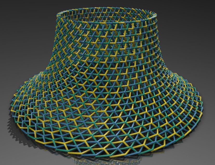

The three groups of colors are in fact the same pattern with a simple rotation.
My goal is simple, I want to obtain three elements at the end of the generation, three domains.
This first domain is then duplicated (simple rotation) to create 3 independent domains which overlap (here a blue domain, a yellow and a green).

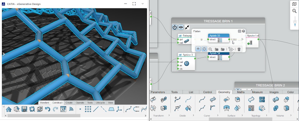

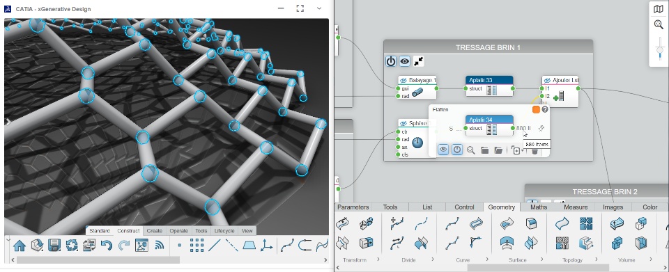

For the moment, at the end of the generation, I get a list of elements, made up of a list of circle sweeps and a list of spheres :
List of circle sweeps :
List of spheres :

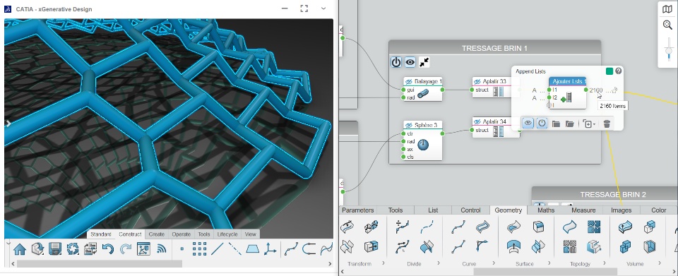

List circle sweeps + spheres :
My problem is as follows : How can I trim and assemble all of the items in this last listing to get a single closed surface of this domain ?
