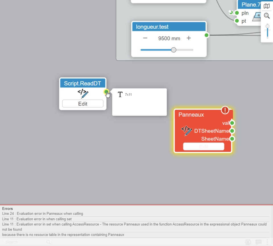

Hi Folks,
Did you ever try or succeed to retrieve a sheet pointed in a local resource table from the scritp Editor ?
Here is my script and a screenshot of the error.
I have no idea if xGen has the capacity to read a local resource ?! @TV
In my tests I was able to retrieve the DesignTable Sheet but not the Sheet from resource table.
Thank you
