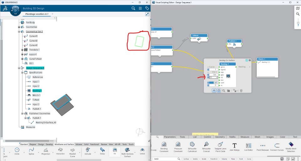

I am trying to use the "nesting" node from visual scripting editor, my aim is to know if a wire can be contained in another one.
Do you know if I am using the right Node ?
My steps are :
  • Get input surf support
  • Get input curveToNest
The result is good when I use a wire close from support, which lead me to questions :
  • when I try to nest the corresponding surf of the "curvetoNest", I have an empty output. We do have to input only wire in "geos" ?
  • When I try to nest with the same wire in green : I have an empty result. Do the support and geometry to nest have to be rotated to fit ? (I tried 2D and 3D "rot" options
