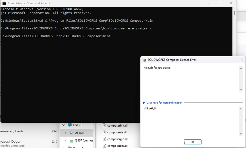

To troubleshoot, I tried registering composer.exe as a COM server using:
regsvr32 composer.exe
My questions:

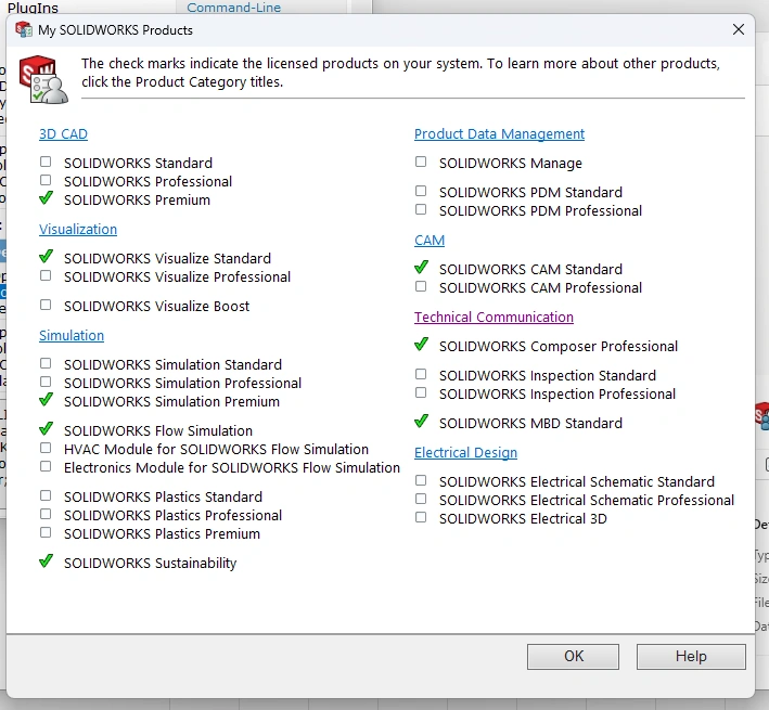

- Is this error caused by missing files, a licensing issue, or something else?
- Is there a specific way to register SolidWorks Composer for COM automation?
