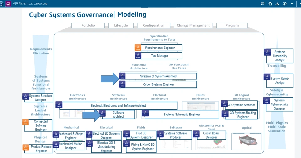

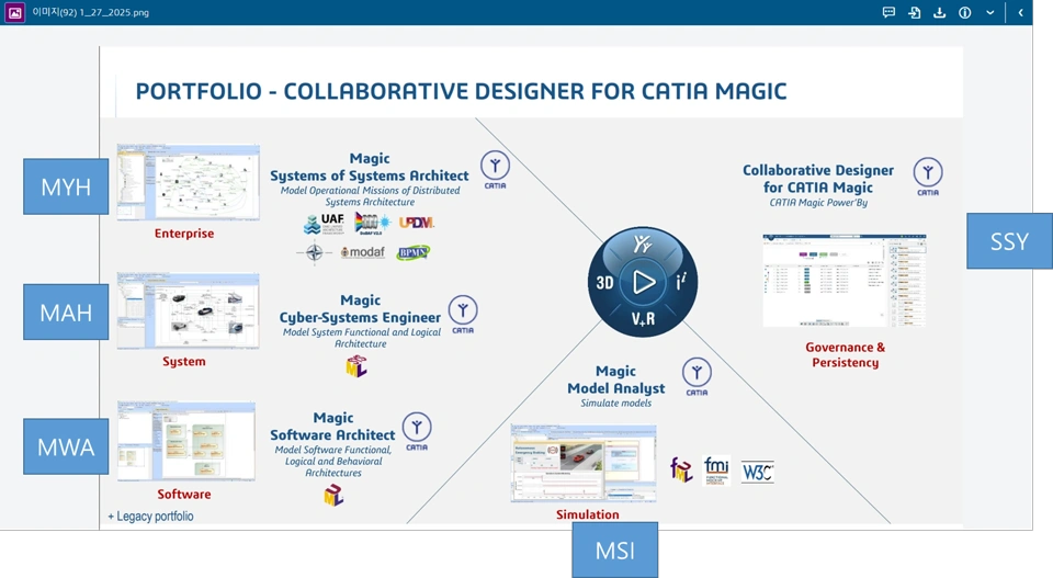

I am currently working on organizing a CATIA Magic license mapping table in Excel. As part of this, I would like to clearly understand the differences between Magic Cyber Systems Engineer (MAH) and Magic Systems of Systems Architect (MYH) licenses.

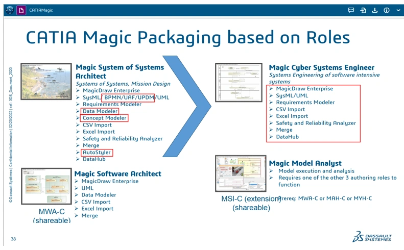

  1. From what I understand, MYH offers more features and is priced higher than MAH. However, I would like to know how these differences impact actual users.
  2. In practical terms, what specific limitations or inconveniences might MAH users experience compared to MYH users?
Could anyone provide more detailed insights into the key differences between these two licenses? Any explanations or real-world examples would be greatly appreciated.
PS: To help clarify my question, I have attached an image that I used as a reference.
