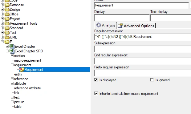

Hello,
I tried to update the requirements on enovia with excel document like verification matrix that has columns ID, Requirement Text and attributes. But the requirements on the enovia is not imported with reqtify so there is not intermediate file.
When tried to update requirement set on the enovia with reqtify, it deletes all existed requirements and create new ones.
I am using labels as ID (as you guess it different than name or identication on the enovia) shown in figure2. I tried to change or arrange the settings while import (figure1) but its not worked. after couple attemps and trial and error I realized the reqtify needs to name or identification for matching requirements on enovia.
is there any solution with that solution for updating requirements with excel file?
                                                               figure 1                                     figure2
