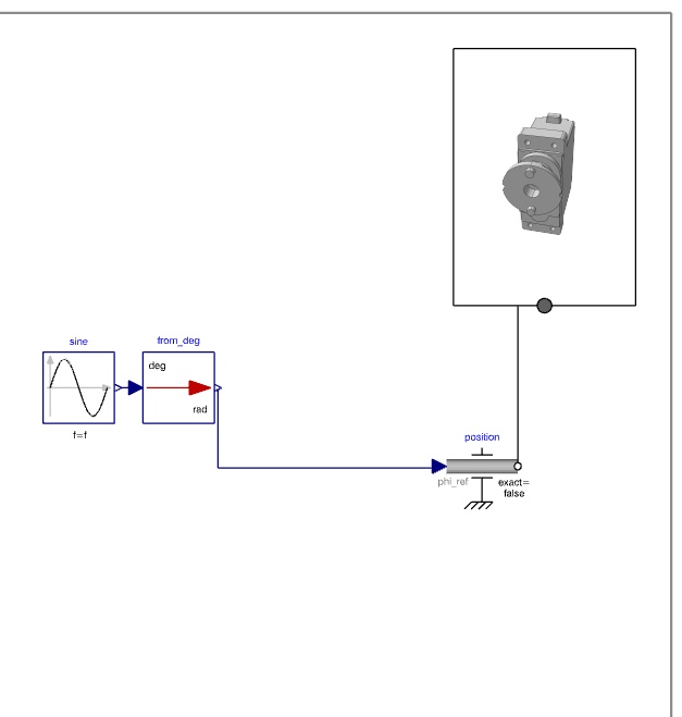

I'm currently just trying to control the CATIA servo with a Modelica sine block, no Arduino involved. Simulation runs perfectly fine if this is all in one Logical Reference, but when trying to connect one logical reference as the "Control", just with a sine signal coming out, and the other one as the "Servo", taking the input of control and getting it to the mechanism, it runs very quickly and without any visual in the model.

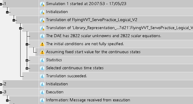

I'm pretty sure this is not supposed to happen. What can cause this? I attach a screenshot of the simulation message reporting. I don't entirely know what initial conditions are not specify or how to specify them.
