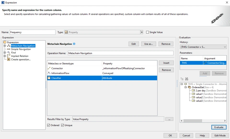

Is there a way to return a value from the ordered set provided from the metachain?
For instance I have 4 value types associated on the block and want to create a table that displays the 3rd value from that returned chain in a custom column.
