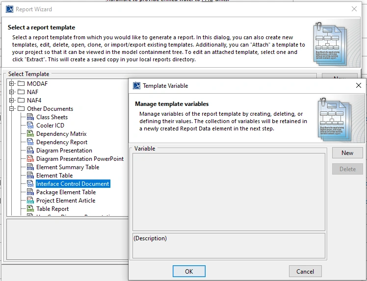

I expected that when I use the report wizard to create the document, I would use the "Variable" option to fill out the document's variables.  But the variable GUI doesn't list any variables.
I expected to see all my \\\$variables show in the "Manage template variables GUI, but it's blank as shown below.  I did try with some templates that are included and while I can edit their variables once I clone the template to something project specific, my text associated with the variable doesn't appear in the generated report.  What am I doing wrong with Report Wizard and my template?

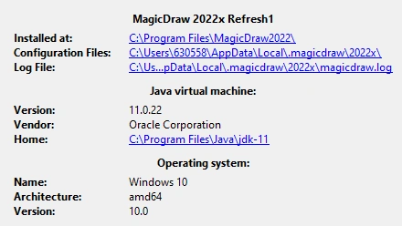

I'm using MagicDraw 2022x Refresh1 with the SysML 2022x Refresh1 Plugin
