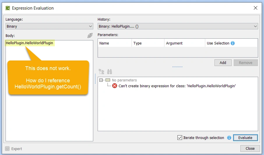

I have created a (working) plugin (in Java) whose class is HelloPlugin.HelloWorldPlugin.class
This class has been packaged into a jar file called hello_plugin.jar and placed in the
C:\\Program Files\\Cameo Enterprise Architecture\\plugins\\com.bretta.helloworld folder.
HelloWorldPlugin has a public methods called getCount() and setCount(int count).
- What would my importClass statement (Javascript Rhino) look like to access this class?
//Script body written in Rhino Javascript, running from a Structured Expression... importClass(HelloPlugin.HelloWorldPlugin); // this import does NOT work! HelloWorldPlugin.setCount( 123); HelloWorldPlugin.getCount(); //return this to the Structured Expression
- How would I reference this class in a Binary Structured Expression?
- How would I reference this class in a Binary Opaque Behavior? (Might be the same as the above.)
