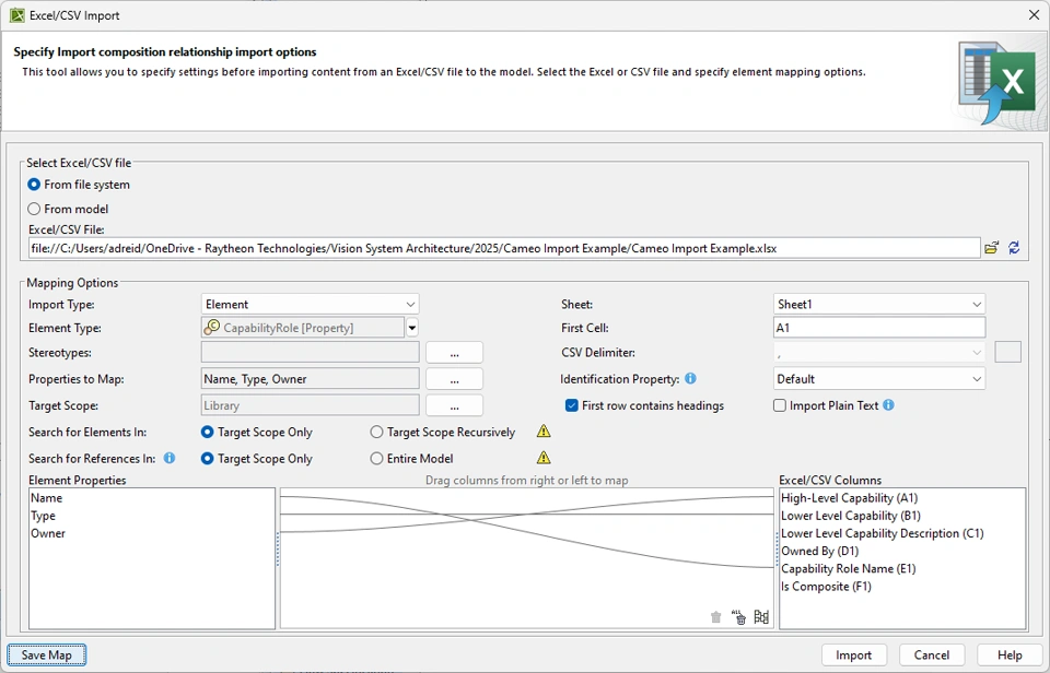

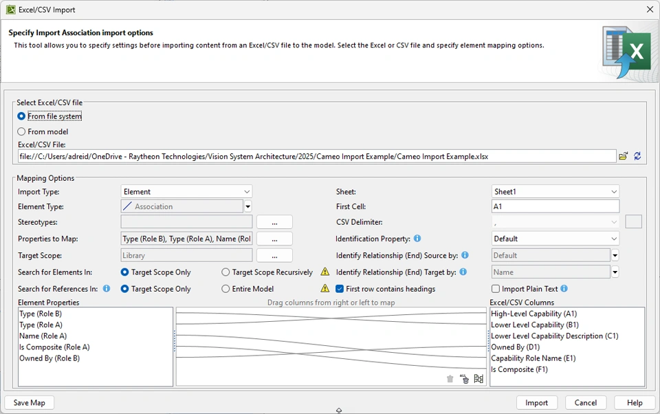

Here are the details of my two relationship related import steps.
These are the settings that I have tried when importing the CapabilityRole
These are the settings I've used when importing the association

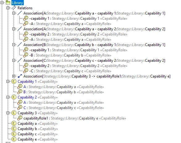

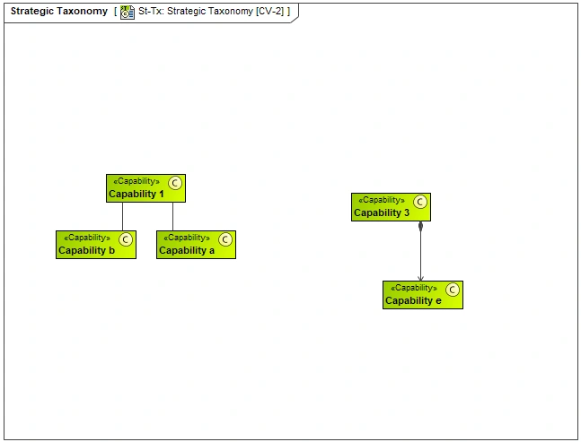

these steps result in the following model (Note, I manually added Capability 3 and Capability e to see how it should really be captured in the model)
