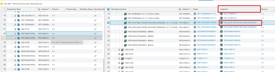

I have an MBOM structure containing both scoped and implemented products. In some cases, an alternate product is used in the MBOM.
To get back to the original part/product, I need to navigate through the Implement relationship from the alternate product. However, I cannot seem to find a method that allows me to retrieve this relationship.
Is there a standard/default method available in 3DEXPERIENCE to navigate from the alternate product to the original implemented product, or would this require an OT Script?
