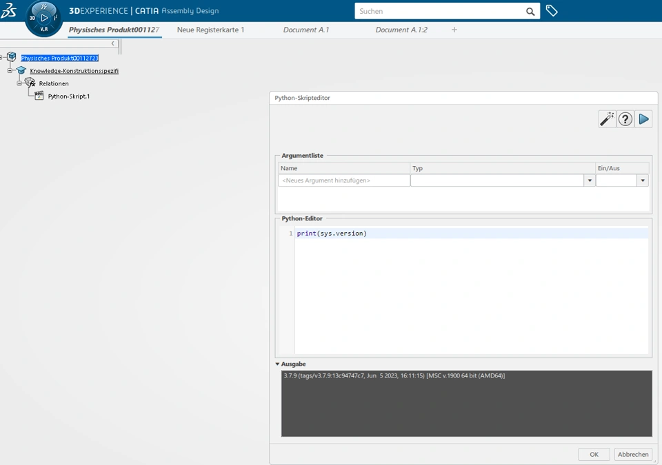

I want to import packages from an local environment to the python script editor.
Does anyone have an idea or process on how I can change the Python version of the python script editor? Please see the screenshot below. I need a newer version. It's possible to connect it to a version from my local device, as I want to use special packages from my local environment?
My Python packages come with version 3.10 and the editor on the dassualt cloud has the 3.7.9. So the import of packages from an extern libary path like C:\\Users\\testuser\\.conda\\envs\\testenv\\Lib\\site-packages is not possible.
