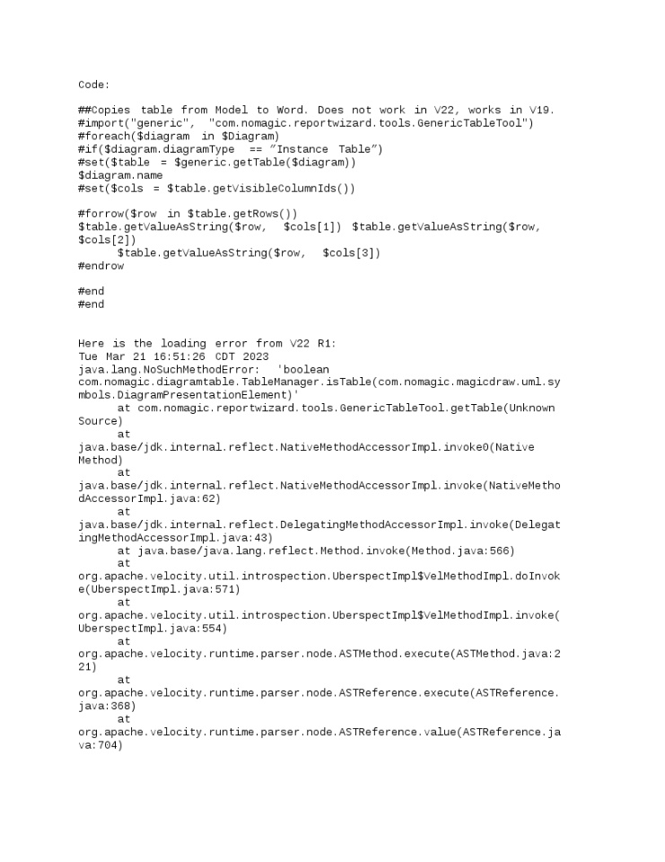

We have a large audience that does not have Cameo access. As such, I am working on generating a test report template. It uses a structure with Test Scenarios, Test Cases and components that make up the test cases which verify requirements. I am using derived expressions to create tables required to meet our needs. When using Version 19, I was able to export those tables to a Word document quite easily using the genericTable WIN! Alas, I am unable t0 import the GenericTableTool in version 22 refresh 1. A member function seems to be missing. I attempted to implement via the diagramTableTool, but cannot actually access cell values successfully. Attachment shows script as well as loading error. Thank you!
