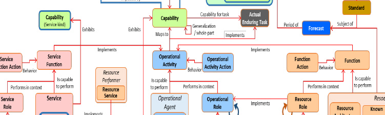

UAF We are having an issue with the UAF implements relationship where Cameo EA will not allow us to establish an implements relationship between a Service Function and an Operational Activity which is a permitted relationship in UAF v1.2. 2022x allows the implements between a (Resource) Function and the Operational Activity.
Please advise and let me know if there is a work around.
